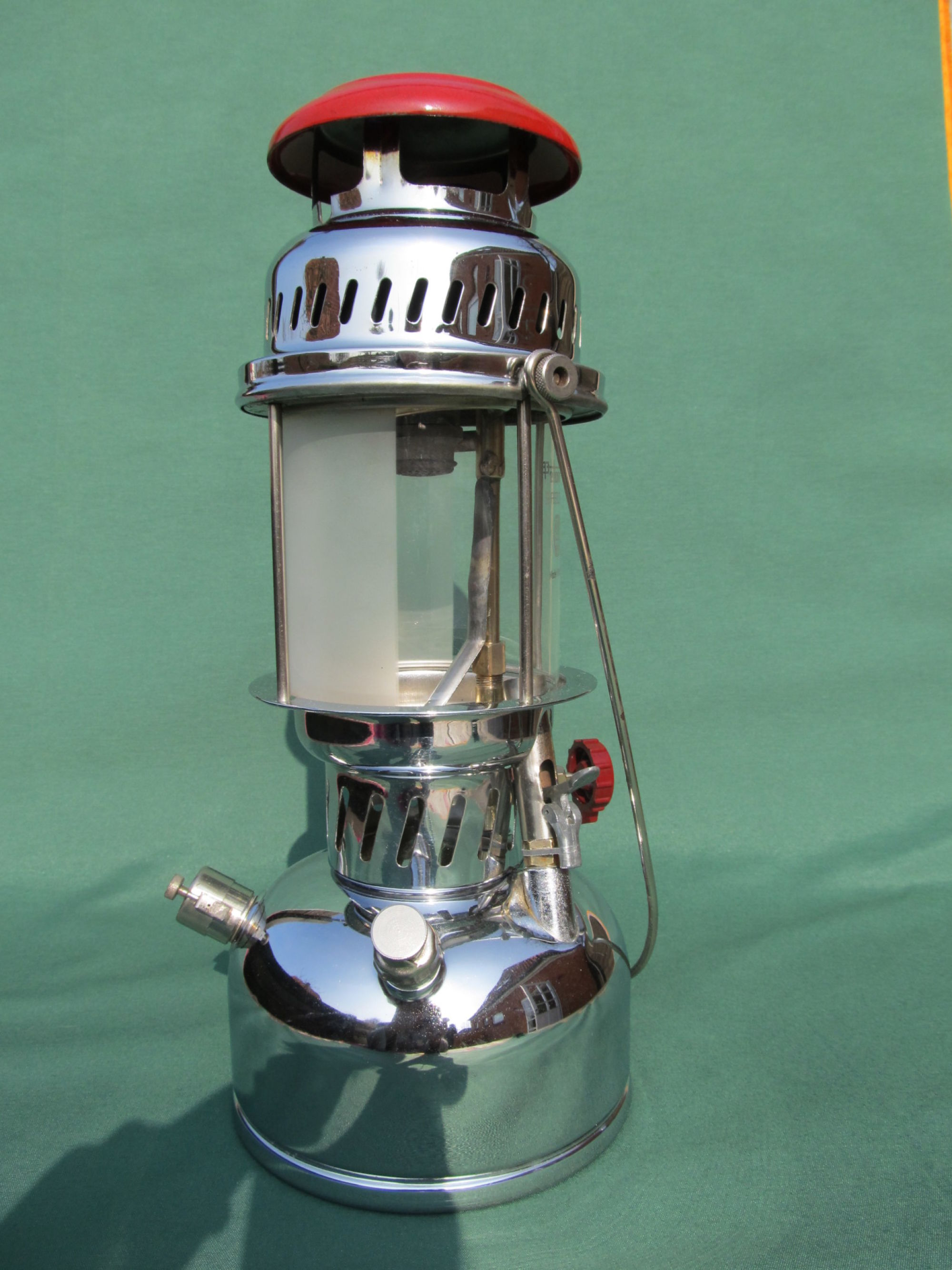

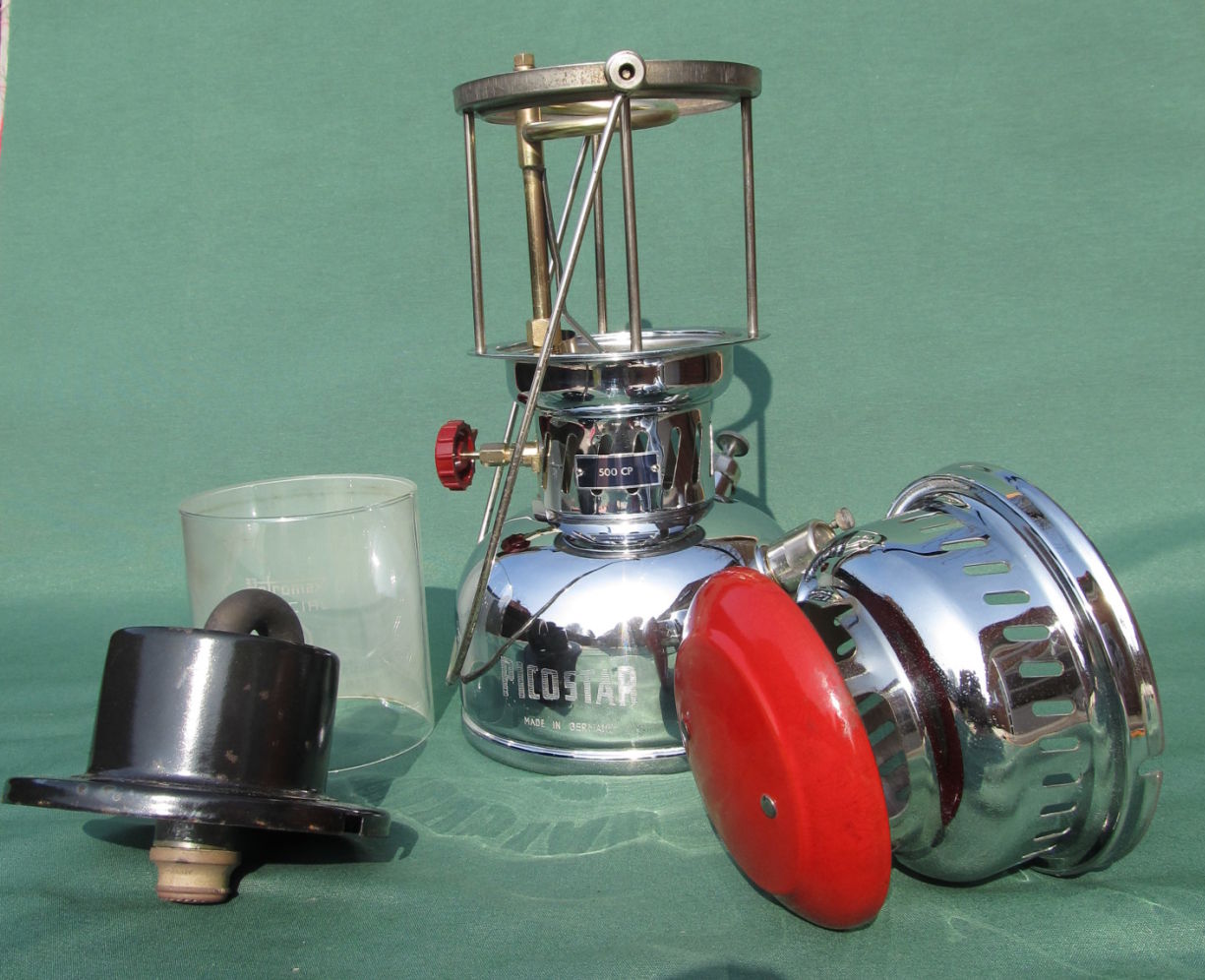

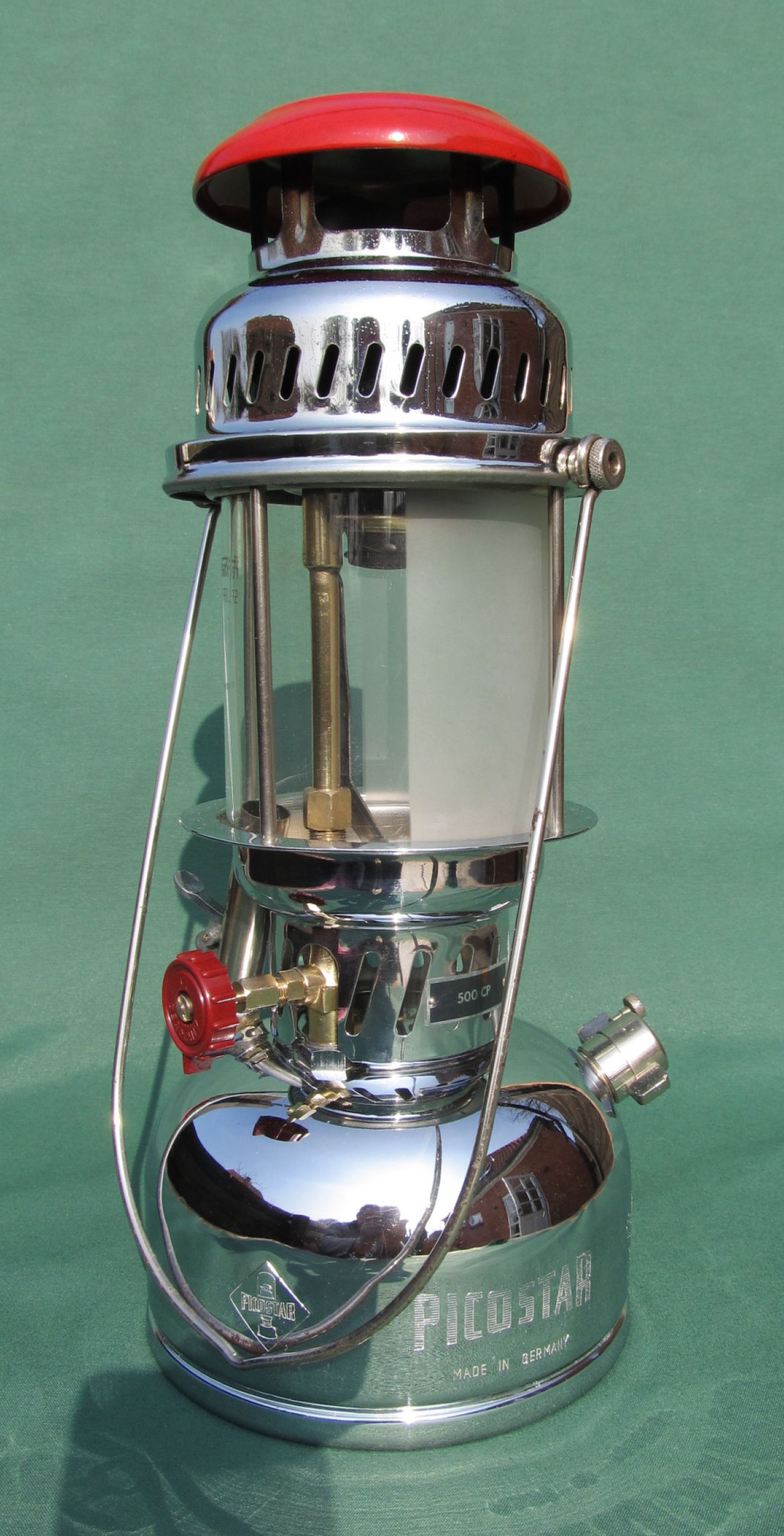

I just got this fine lamp. They dont show that often here in Danmark. Anyone who knows anything about it?
A Company called Day Lite from Ciemcy makes almost similar looking lamps and there also exist a Lohmann with similar look, but these lamps can only be attached to Picostar by the look.
If Day Lite produced the Picostar, then the Company was in Hamburg and is called "Meyer & Niss" but I have seen no papers supporting that.
The lamp is in good quality and I think it looks nice.
