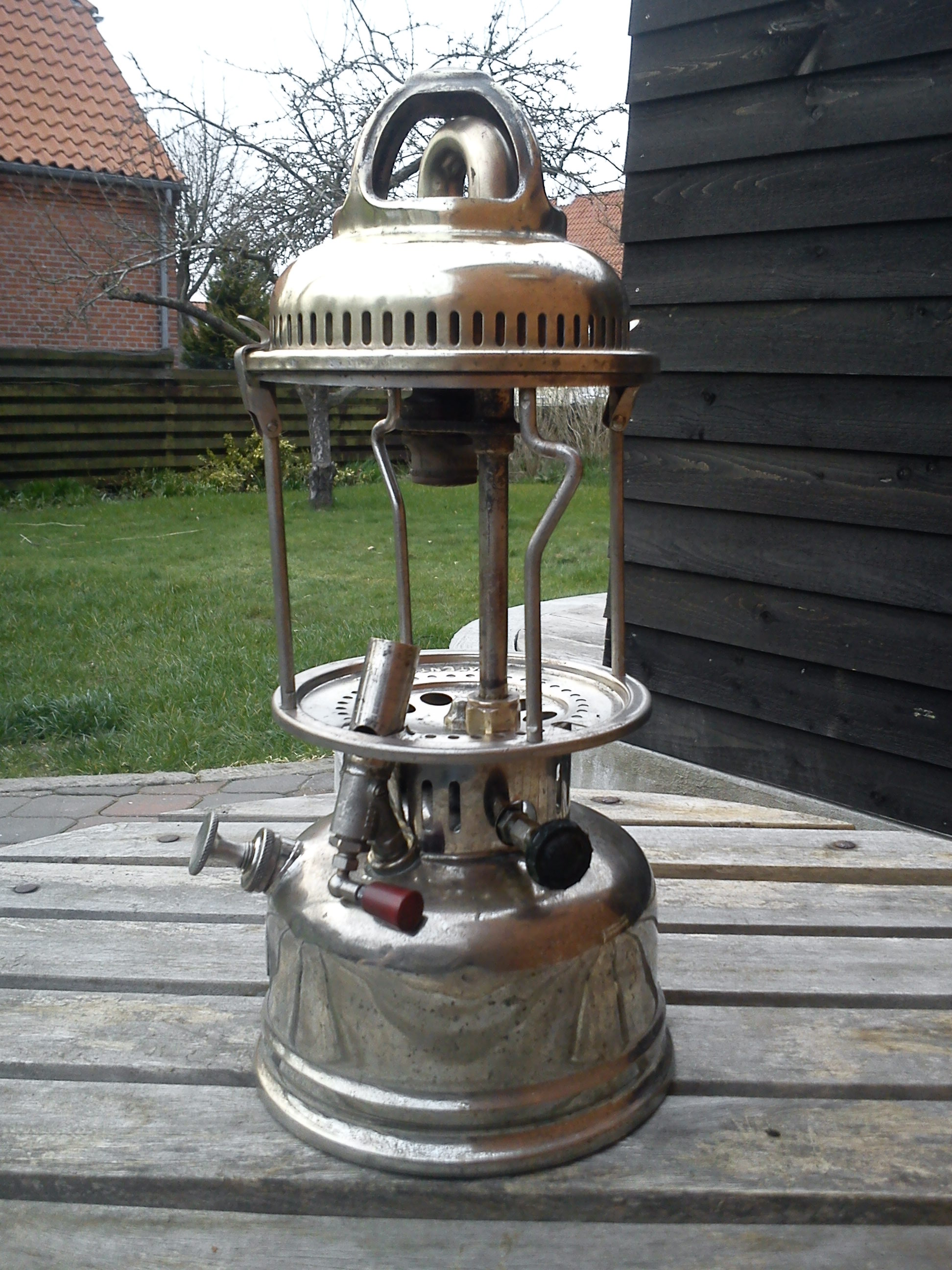

I am going to make a new tophat for my Primus 1381
This is the technic I will use. Does any of you Guys try this ? Idea

I doesent look difficult. I will try first to make a form of hard-wood and see how it goes. I am not into mass-production so if the wooden form holds to just 2-3 then I will be a happy daneSmile

Yeah but - a top for a Primus 1381 is made of iron and not soft brass and that bothers me a bit. It have to be iron while it later is going to be enameled green. That is not possible to do with brass.
Iron is no so shapeable as brass and if Wood wont hold, then I dont know what to make the form of Dodgy
If it should be made of steel you should ask for proper kind of steel. Probably it is possible to do that if you made that steel very hot. Mayby it is possible to made it from a kind of metal ( steel ) cup or similar thing?
If you want to enamel it later, you have to use special steel for enameling like DC0x EK.
x defines level of 'drawability'. I used DC01 EK2 (british CR 3 VE) for enameling.
Becouse you want to enamel it later, steel can be very, very thin (if you ever tried to sandblast enameling from some original roof/lantern, you know what I am talking about).
Thin steel is almost as soft as brass - you can easly bend it in hour hands, so it is no problem for lathe and wooden form. It gets hard and inflexible after enamel coat.
Of corse, you can make harder form from harder materials like epoxy.
BTW, it is possible to enamel brass and copper, but it is very hard to find someone who knows how to do this.
Here are steel types with standard designations in different countries: http://www.mpmetal.com/steelstandard.php - this should be helpful when you search for correct steel for do your top.
